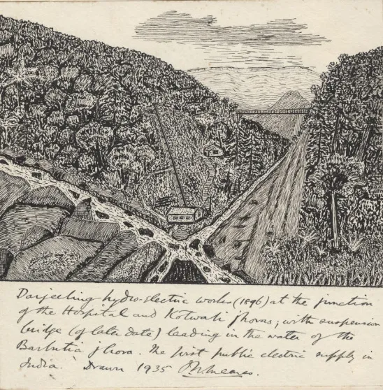

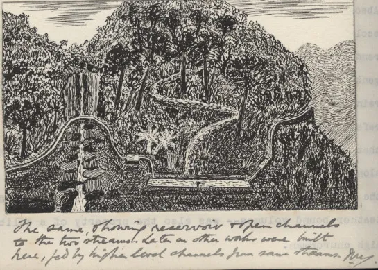

'Having had no connection with water power ... I now found myself in sole charge of the construction, and to some extent, the design of a pioneer installation... The problem before me was to build a reservoir of 40 000 cubic feet capacity, for one-fifth of the sum which a Public Works Department engineer said it would cost; then to bring water to it from two streams through several miles of galvanised ion channel laid either in dense jungle or on almost vertical cliffs;
to connect the reservoir with a smaller one as a forebay; to lay two steel pipes down a steep hillside to a small power house; to erect and test the turbo-generators and their switchgear after building this power house; to put up a three mile overhead transmission line, three or four sub-stations in the town, and place lights in all the streets.'
John Willoughby Meares records in his autobiography, `At the Heels of the Mighty', 1934 (SC MSS 169/1/1), donated to the Archives by his son, Stanley Meares, that the Darjeeling hydro-electric scheme, not only would be the first installation of its kind in India, but also the first public electricity supply scheme of any sort there. He took up his appointment with Kilburn & Co of Calcutta in 1896, aged 25.

The damage to Meares's 'embryo works' was considerable. Despite this, the job was finished before the end of 1897, less than a year after work began.
In September 1899 there was a cyclone in Darjeeling 'bringing some 40 inches of rain down within 48 hours'. Meares, now working in Calcutta, returned to see whether his station had survived.
'I went to see my works in the valley below, with the Municipal Engineer, the undertaking having meantime been taken over by the municipality. As already mentioned, the power station was at the junction of two streams; a great landslide had occurred in one of them, blocking up its bed to a height of about 40 feet immediately below my small building. The full force of the stream in spate fell upon it, and before the landslip dam was breached the power house was ten feet deep in mud, only a few of the contents showing over it.
The staff got quickly to work and cleared the mud, washing out everything even to the high-pressure alternators with jets and buckets of water; then everything was dried out with charcoal fires, and after about 6 weeks the plant was working again as though nothing had happened; in fact, those Crompton-Brunton alternators are still doing duty [in 1934], to the credit of their manufacturers, though the type has long been extinct.'
