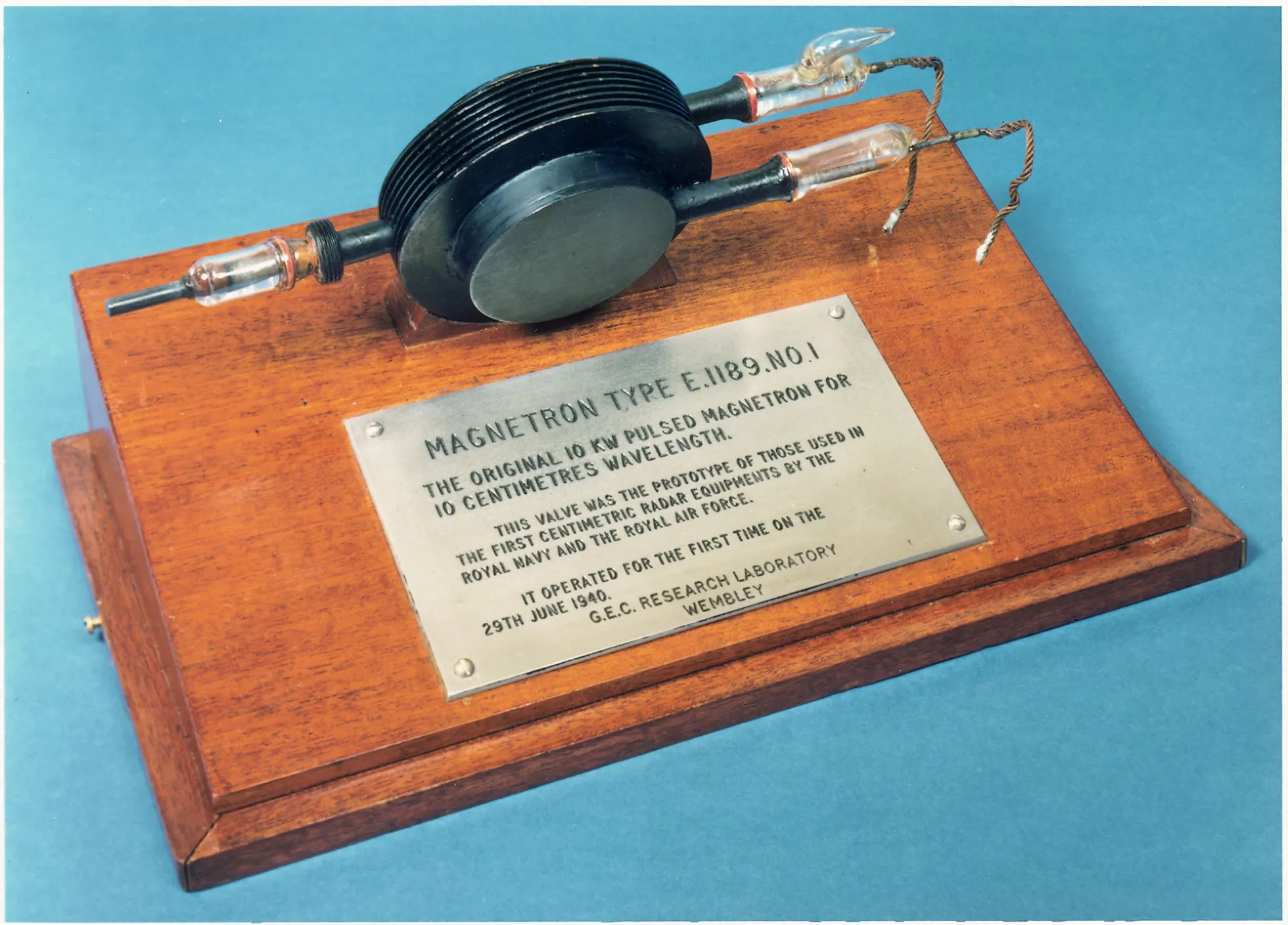

The cavity magnetron was one example of this. Staff at the Wembley laboratories first heard about it in April 1940. Randall and Boot's magnetron was a laboratory device yielded only low power when operated continuously, and was located in the magnetic field of a laboratory electromagnet producing a steady field. The Wembley staff introduced developments which produced a high-power, pulsed, sealed valve, using a permanent magnet with a new type of cathode, suitable for operational use.
The prototype of this design was tested on 29 June 1940. Others were quickly produced in the laboratories, as the wartime need for the magnetron was so urgent that there was no time to transfer a design to a factory before early demands had been met. One of the early GEC magnetrons was flown to the United States and demonstrated there by members of the Tizard mission.
